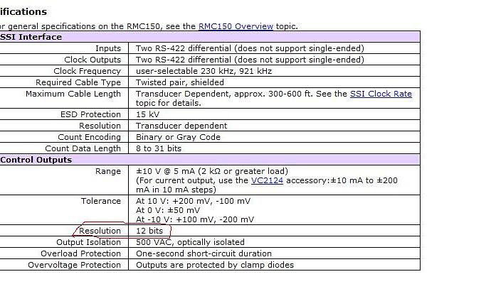

thank you for your reply。
e.g.
the min speed= 2mm/s max speed=500mm/s
500mm/s Corresponding voltage 10v,that means 2mm/s Corresponding voltage=(2/500)\*10=0.04v
qestion 1:
I want to know Whether the resolution of the analog output can meet the requirements？ the resolution of the ssi module analog output=10/2048=0.0049?
qestion 2:about measurement interval
Project requirements :
speed: 2mm/s Amplitude ：1.8mm frequency: 10hz sine
what should i pay attention ？？
 ![1.JPG](https://forum.deltamotion.com/uploads/default/original/1X/96850cb5ccc9d82c89deadaf29176b2753c5c434.jpeg)

Answer 1: Yes, the analog output can meet the requirements for the slow velocity, because in closed-loop control, the analog output is continuously changing at a frequency of 1 kHz. The system response is much less than 1 kHz, so the analog output is basically averaged and results in a very well-controlled velocity.
Answer 2: I think the standard settings in the RMC will work just fine. These are very typical requirements that the RMC can easily meet. Just follow proper system design, such as high-resolution feedback, a servo-quality linear valve with a zero-lapped spool, the valve mounted on the cylinder or as close to the cylinder as possible.
