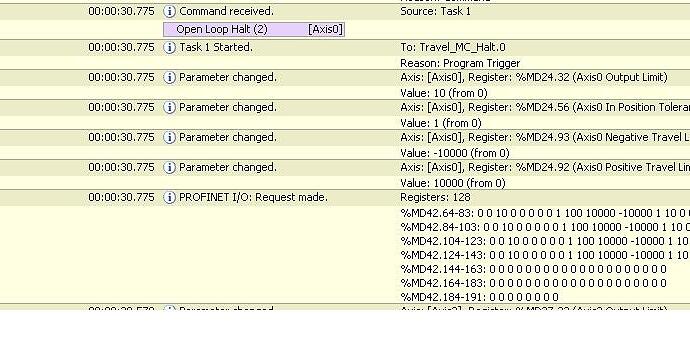

When power on, the siemens and deltamotion start。 the RMC150 starts faster than Siemens cpu。

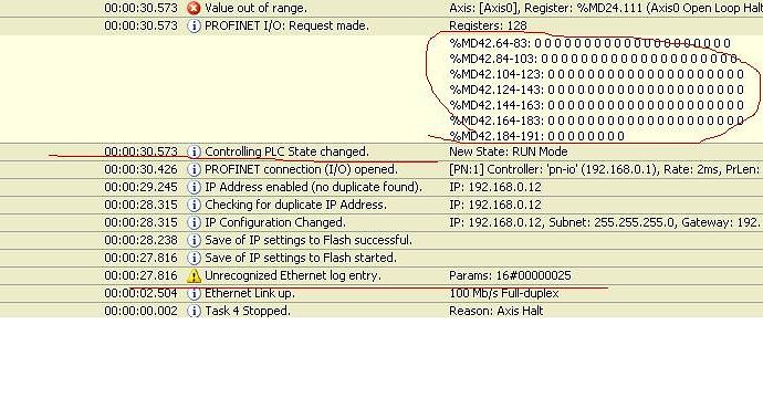

When the rmc150 start is completed,the same time rmc150 read the data form siemens cpu。 the siemens cpu send zero to rmc150,Because the siemens has not start。 see the attachment “plc not start and rmc150 start completed”
When the siemens cpu start is completed,the data Transmission is ok。
I think there are some quesiton
1:about 24 unregconnized ethernet log entry param 16#00000025, what’ s the meaning
2:about 31 controlling plc state changed new status run mode. that’s not correct. because from the data from plc deciding ,the plc dont start at that time。
3: how to Avoid this case。
detail see the attachment about event log 3.rmcelog (28 KB)
2: From the RMC’s perspective, the state was formerly unknown. When the connection established, it changed to a known value, which is RUN. It is understood that when this message occurs when the connection is made, it does not mean the PLC actually changed to RUN mode.
3: This case does not matter. It is only an Event Log entry.
