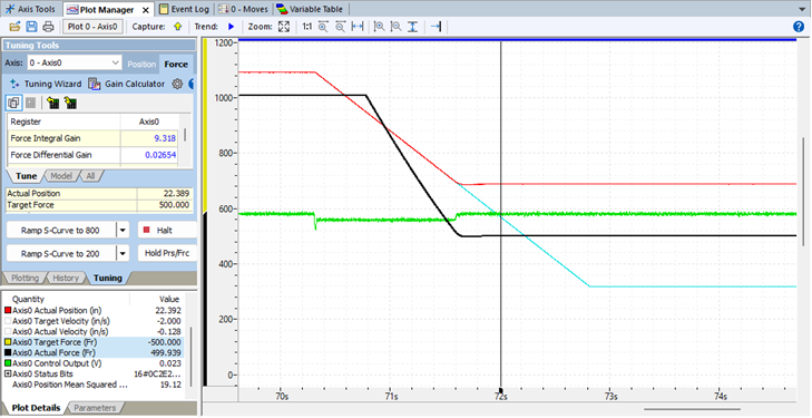

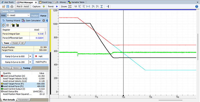

Here is a plot demonstrating this:
Notice in the Plot Details window that the Target Force is -500. The Target Position starts at a high value, and moves in the decreasing direction. As the Actual Force approaches 500, it is limited, which is also evident by the Actual Position coming to a stop.

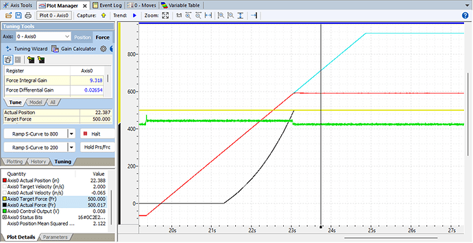

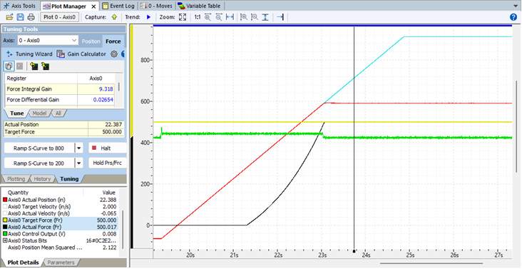

For comparison, below is a plot of a normal force limit situation, where the force is limited to a positive value in the increasing direction, that is, the force should not exceed that positive value. This was achieved by setting the Target Force to 500 and setting the force control mode to Positive.
In this plot, the Target Force is 500. The Target Position starts at a low value and moves in the increasing direction. As the Actual Force approaches 500, it is limited, which is also evident by the Actual Position coming to a stop.
