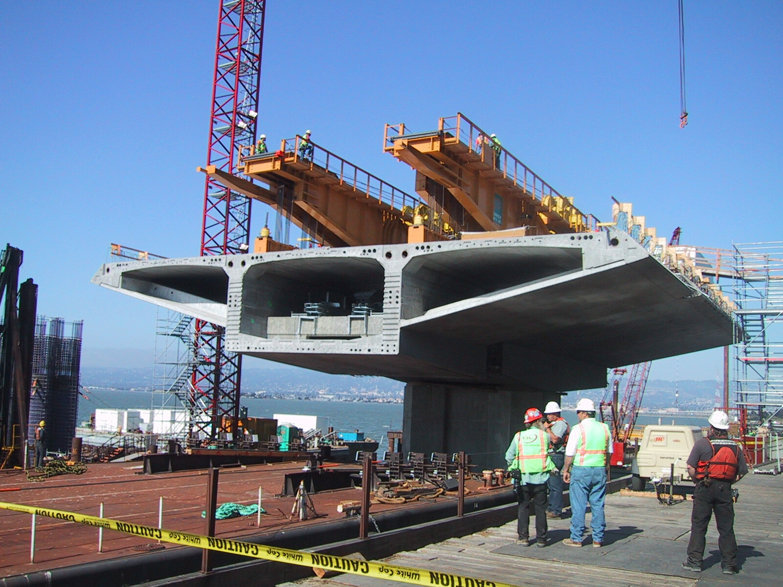

BTW, the is picture of raising a section of the New Bay Bridge in San Fransico bay. 3 winches had to be synchronized. A RMC100 was used for this.
