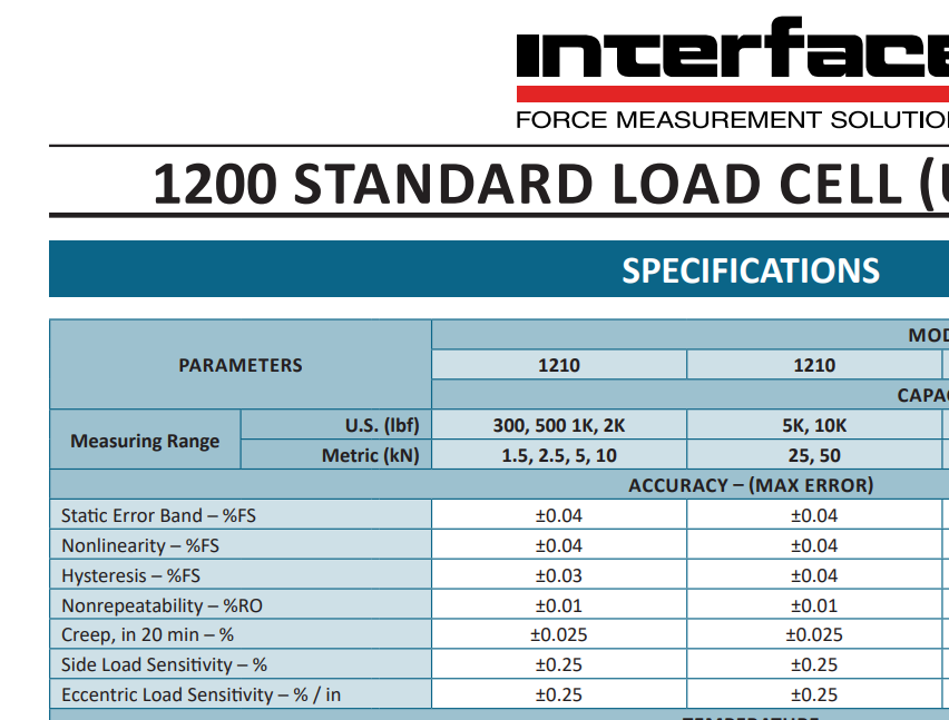

I think it’s better to try this with an external load cell connected between the rod and workpiece. Good quality standard load cells have ratings in the neighborhood you are looking for. But I usually see them listing all the different types of accuracy. So it’s hard for me to figure out an overall accuracy of a unit. Interface is a popular load cell manufacturer. Here is a snippet from one of their standard load cell data sheets:
So while each one of these numbers is below 0.1%, I think they may combine to actually be more than 0.1% in some worst case (maybe even not worst case) situations. Also see in this chart that side loads and eccentric loads really affect the accuracy. This means that mounting is very important.
We had a system for testing a range of parts and the only solution was to set it up for different load cells for different size parts. They originally wanted to just size the load cell for the largest forces. But in the end, they really needed the accuracy on the smaller parts which dictated using lower range load cells for those parts and changing the load cell out as the parts got bigger.
