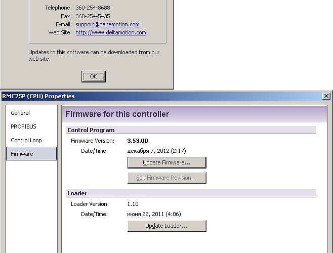

Today I downloaded firmare for the RMC75P ( Version: 3.53.0Date: 12/7/2012Size: 2.2 MBType: BIN file) and updated my PLC, but problem remained.
Can you check this problem again, please.
Today I installed new RMCTools (Version: 3.53.0Date: 12/7/2012Size: 14.8 MB).
But problem remained.
