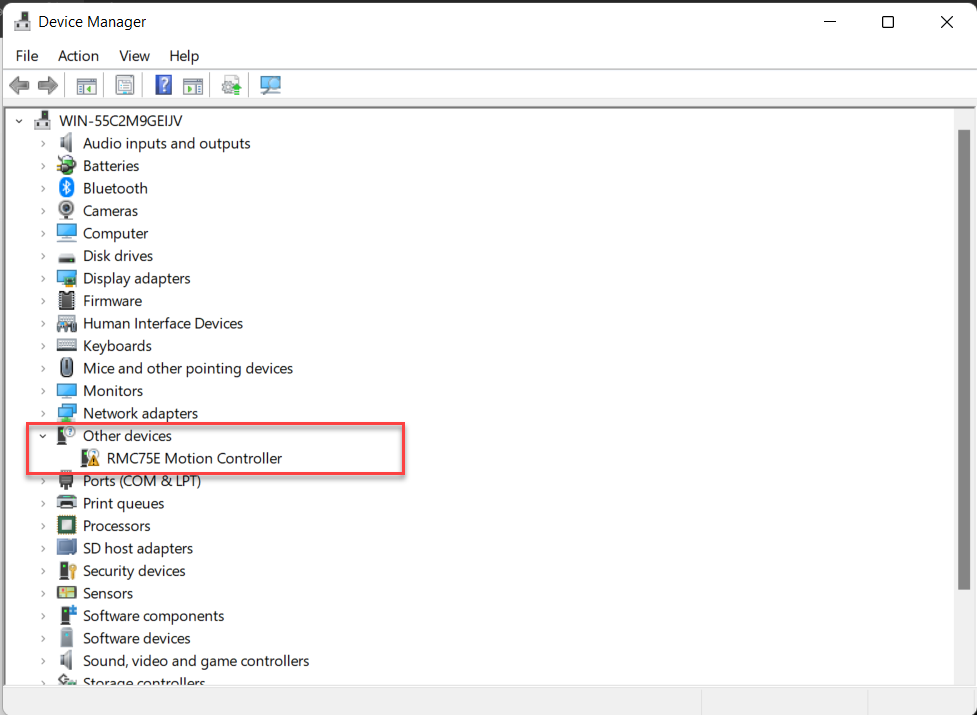

Open Windows Device Manager. Locate the RMC under Other Devices.
Right click the RMC and select Update Driver.
In the Wizard that appears, select Browse my computer for drivers and click Next.
Browse to the location of the drivers that were downloaded and unzipped earlier. Click Next
Windows should find and install the drivers. The drivers should now work for any RMC75E or RMC150 that will be connected to the PC. If it doesn’t, you may need to repeat this process for each controller.
