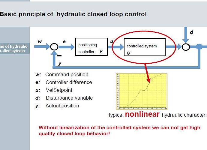

I think hydralic value must Valve linearization,because the hydrilic is non-linear between volts and velocity,unlike electrical axis. IF don’t Valve linearization,
Control results is not better than value linearization。
Previously used siemens technology tcpu and scout, Valve linearization is the Key。
In the RMC Controllers, the non-linearity between voltage and velocity is compensated for by the closed loop control.
Valve linearization in RMCTools should not be used on linear or nearly linear servo or proportional valves.
How the closed loop control compensated the non-linearity between voltage and velocity? Can you give me a example Explanation?
2.jpg is the"Basic principle of hydraulic closed loop control"

If the valve is non-linear, then certainly, using valve linearization is the key to achieving good performance. However, the key to great performance is usually to use a linear valve.

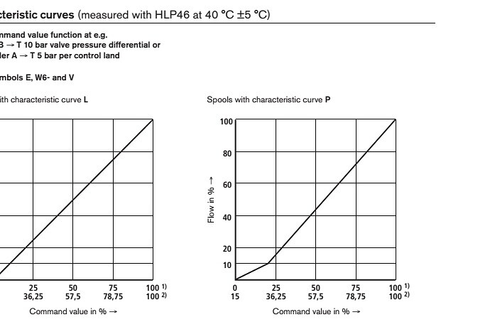

Current my company in the Servo Hydraulic system ,I Often used Rexroth 4wrte series。
Characteristic curves and manual refers attachment。
is the 4wrte value belong to linear valve?

Historically, non-linear valves have been used because the flow gain is lower around zero volts, allowing for very fine control at low speeds, or for very fine pressure control
1:why the non-linear valve can Achieve very fine pressure control?
2:IS linear valve better than non-linear in fine pressure control?
3:linear valve=servo valve? non-linear valve=Common proportional valve?
4: i need to be considered what,in pressure control? press gain is higher is better?
The 4WRTE valve L spool is linear. The P spool is non-linear with a single knee (or kink) in the flow versus command diagram. The L spool does not require linearization. The P spool can be successfully linearized with the single-point linearization in RMCTools.

  1. The non-linear valve will have a lower flow gain in the spool movement around zero command volts. This makes it easier to make very fine adjustments to the flow, which results in very fine adjustments to the pressure.
  2. No, the linear valve is not better than non-linear in fine pressure control, but we find that it is plenty good enough and easier to set up and tune.
  3. There is no standard usage of the term “servo valve”. Traditionally, flapper-nozzle and jet pipe valves were called “servo valves”, and proportional valves, being they had slower response, were not usable for high-performance control like the servo valves were. Now, some proportional valves have as good response as traditional servo valves, to they are sometimes called servo-quality proportional valves, or just high-response valves. I do not think “servo valve” has anything to do with linear or non-linear.
  4. In pressure control, a low flow gain is better for achieving fine pressure control.
