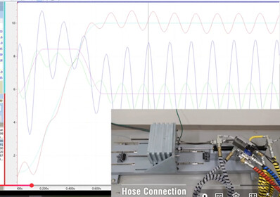

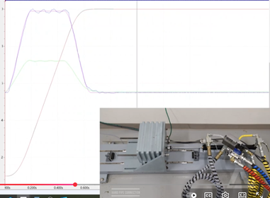

You will see that the long hose oscillates, and the short pipe does not
Long hose:
Short pipe:
