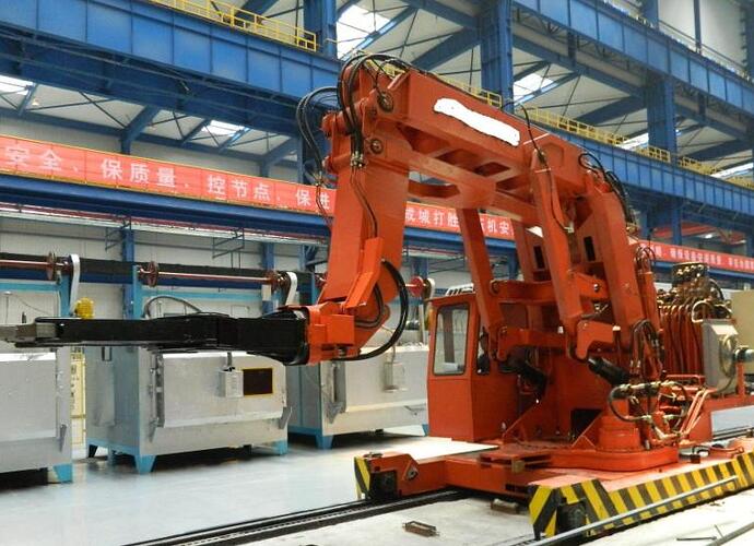

1:My Company robot product in the running progress,
the pressure differential is always changing.So the same volt setpoint,
May be the different flow。
HOW Rmc150 Solute that? always change gains, or else?

my company servo hydralic robot pic
